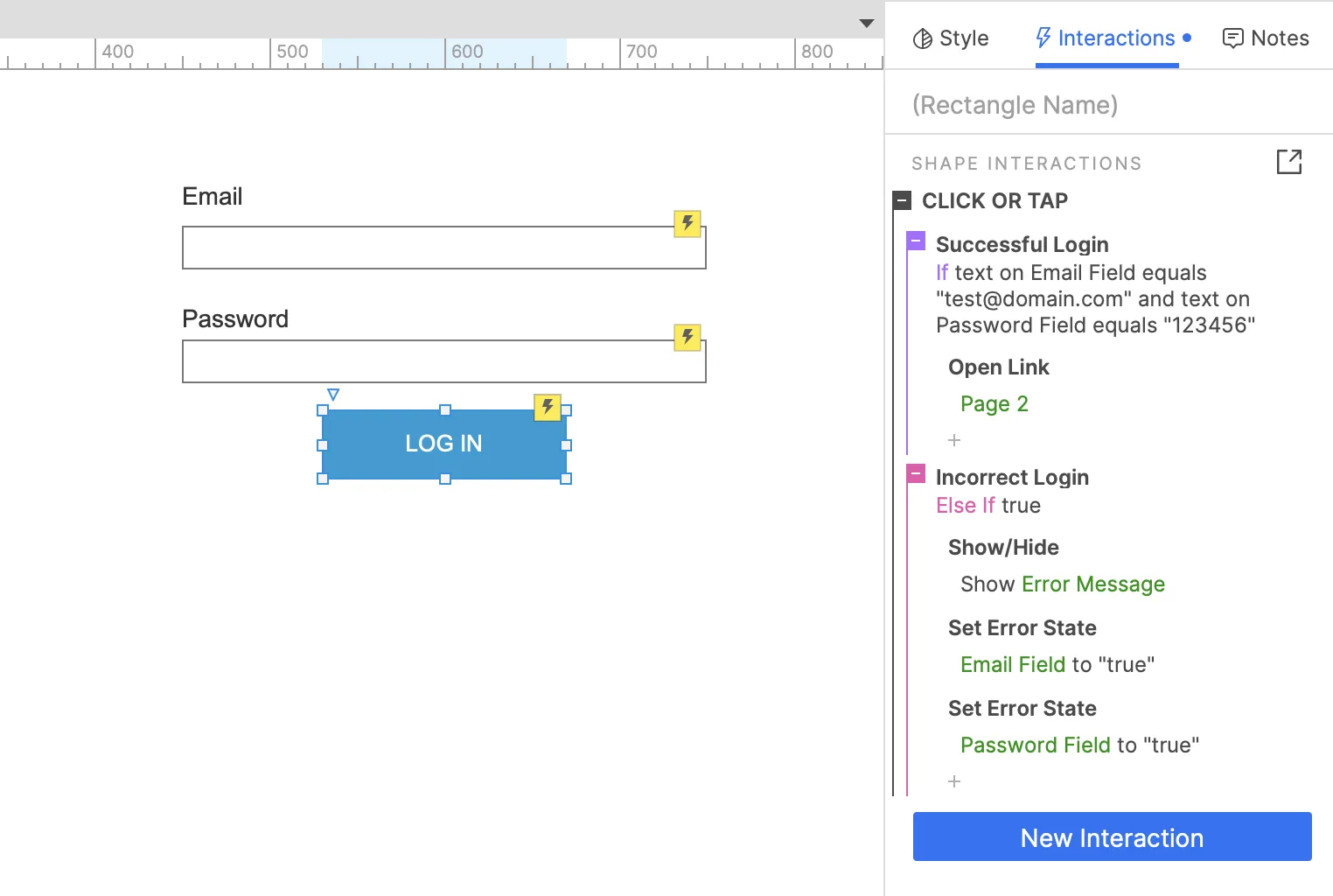

In Axure RP, when you build an interaction, it will consist of events, actions, and cases. Cases are what determines the order or precedence of how an interaction fires, and how you order each case is especially important when using conditional logic. ‘
In the example of a login submission form, you may have a login button with a Click or Tap > Open Link > Page 2 interaction. Then, you can add conditional logic that states “If text on Email Field equals test@domain.com and text on Password Field equals 123456.” You can also take this a step further by adding another case for incorrect submissions, where the user will see an error message or an error state if their credentials are incorrect.
As a result of that, if the user enters each field correctly, they’ll advance to the next page. If they don’t, they see an error message indicating the unsuccessful login attempt.
